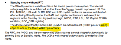

The STM32L073RBT6 can be woken up from standby mode using a wake-up pin (e.g., PA0, which is WKUP1). Please refer to the device datasheet.
Please refer to the Projects/32L0538DISCOVERY/Examples/PWR/PWR_STANDBY to learn how to enter and exist standby mode using wake-up pin.
It is possible to use the same pin to enter and exit standby mode, however it should be one of the three wake up pins mentioned in the datasheet (PE6, PC13, PA0).
