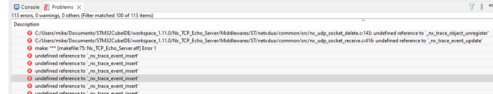

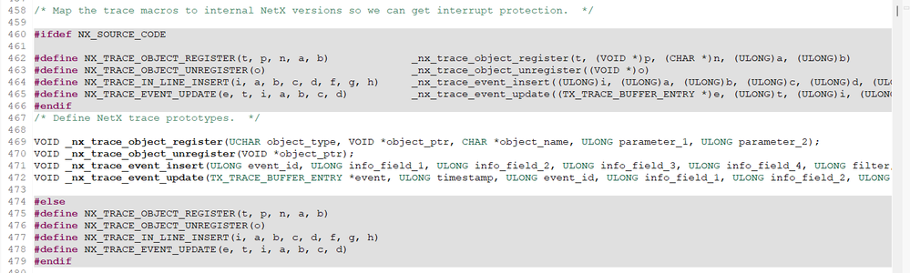

I am attempting to use TraceX in my NetXDuo application. But when I enable TraceX in the Software Packs of CubeIDE (TX_ENABLE_EVENT_TRACE) I get compiler errors in all of the calls to save a tracex event. The macros that defines the calls to tracex services appear in nx_api.h, but are not defined, and hence the _nx_trace_event_ service is never defined.
I saw a discussion of this same issue over in the Renesis community where a workaound fixed the compiler issue.
But t his workaround did not fix the STM code.
Can anyone suggest something that may help?

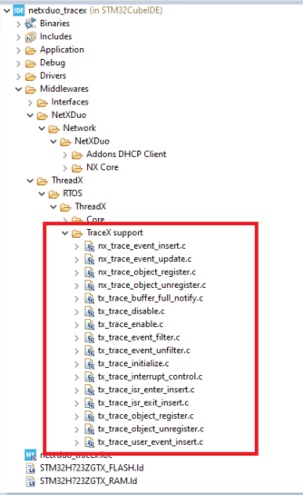

By the way can you check that the NetXDuo trace files (nx_trace_*) are added to your project when enabling TraceX support

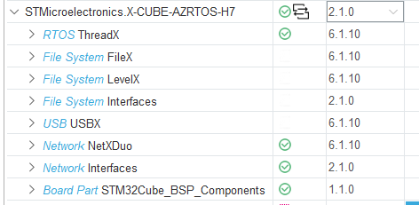

X-CUBE-AZRTOS Versions

By the way can you check that the NetXDuo trace files (nx_trace_*) are added to your project when enabling TraceX supportI don't see any nx_trace_ code inserted into main.c, app_nextduo.c, or app_azure_rtos.c. I manually inserted the following into app_threadx.c per the training video.
TX_THREAD thread_ptr;
#define TRACEX_BUFFER_SIZE 64000
uint8_t tracex_buffer[64000] __attribute__ ((section (".trace")));
/* USER CODE END PV */
...and
tx_trace_enable(&tracex_buffer,TRACEX_BUFFER_SIZE,30);
/* USER CODE END App_ThreadX_Init */Thanks for the help.

I did install V3.0 X-CUBE-AZRTOS-H7 and now see the TraceX support files as shown in your screenshot.

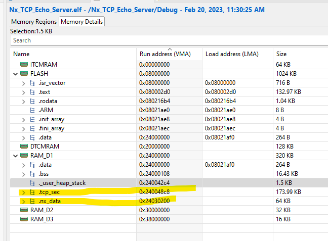

1-I ran out of byte_pool memory when allocating all of the services in my NetxDuo application.
As mentioned in readme file some changes are required when changing the NX_PACKET pool size or address. The NX_PACKET start address (0x24048000) used in this example allows only pool size < 32KB so you you need to set/update start address as follows:
.tcp_sec (NOLOAD) : {
. = ABSOLUTE(0x24030000);
*(.RxDecripSection)
. = ABSOLUTE(0x24030060);
*(.TxDecripSection)
} >RAM_D1 AT> FLASH
.nx_data 0x24030200 (NOLOAD):
*(.NetXPoolSection)
} >RAM_D1 AT >FLASH

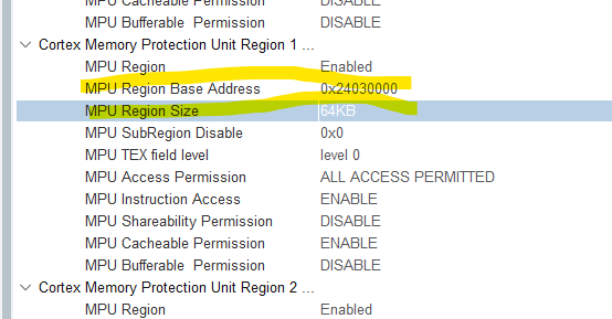

MPU_InitStruct.Number = MPU_REGION_NUMBER1;
MPU_InitStruct.BaseAddress = 0x24030000;
MPU_InitStruct.Size = MPU_REGION_SIZE_64KB;
MPU_InitStruct.SubRegionDisable = 0x0;
MPU_InitStruct.AccessPermission = MPU_REGION_FULL_ACCESS;
MPU_InitStruct.DisableExec = MPU_INSTRUCTION_ACCESS_ENABLE;
MPU_InitStruct.IsShareable = MPU_ACCESS_NOT_SHAREABLE;
MPU_InitStruct.IsCacheable = MPU_ACCESS_CACHEABLE;

I made the memory allocation modifications that you recommended. But I still get a Hard Fault when the byte_pool allocation attempts to allocate greater that 32kbytes.
Here is what I modified.
/* Allocate the memory for TCP server thread */
if (tx_byte_allocate(byte_pool, (VOID **) &pointer,2 * DEFAULT_MEMORY_SIZE, TX_NO_WAIT) != TX_SUCCESS)Could there be some other setting that limits the allocated memory to 32kbytes?
