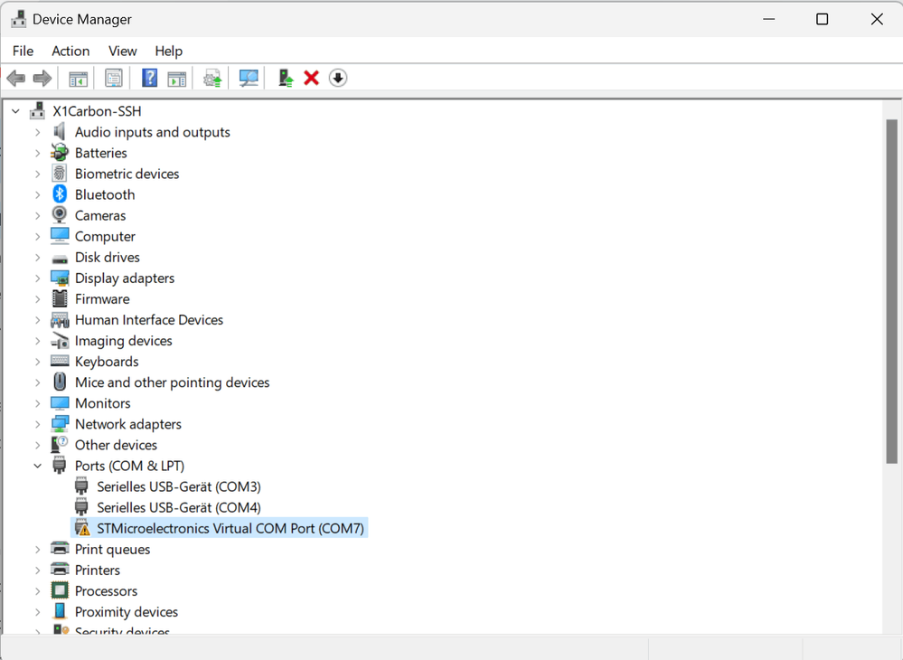

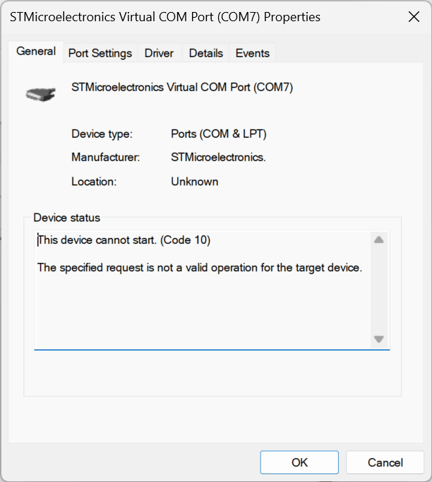

Dear Community,
I keep getting an error message when installing the latest STM32 virtual com port driver on both Windows 10 and Windows 11 - can anybody suggest a solution?
Thanks,
Sascha
2022-12-12 12:56 AM
Hello @SSchu.12 ,
Try increase the heap and the stack size or configure the USB library to use static allocation.
I invite you to follow this FAQ related to the problem "USB device not recognized":
Hope this helps you.
If my answer satisfy your need, please select it as Best so that this thread will marked as solved.
Imen
