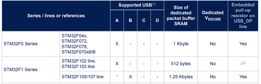

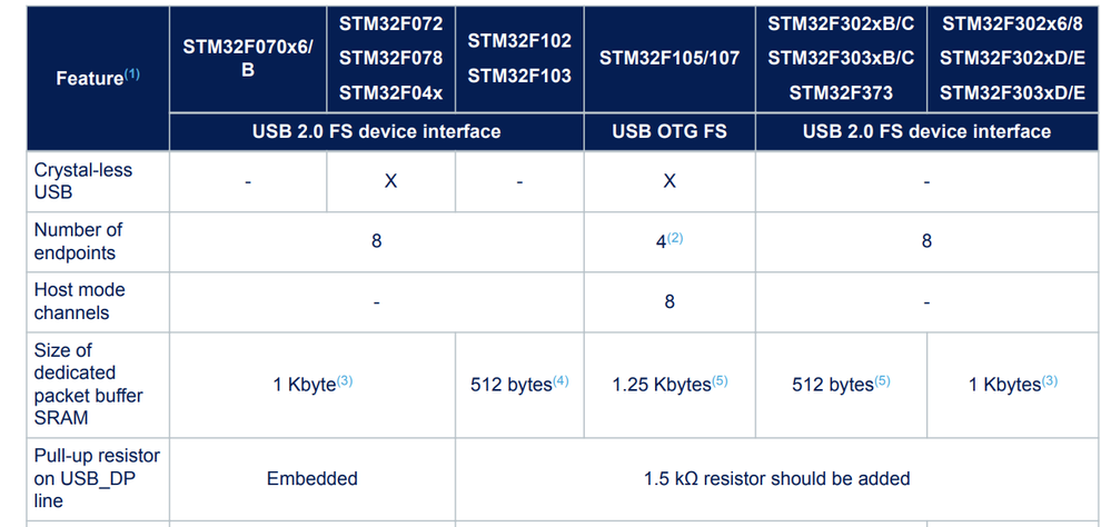

It's bug in that AN4879, the FS PHY used with the OTG module does have the DP pullup (as well as the pulldowns for host mode) see RM0008.
And 'F102/103 don't have the embedded pullup.
@Imen DAHMEN , can these please be fixed?
Thanks,
Jan
2020-06-30 5:47 AM
Thank you for bringing this to our attention. I will raise this for fix.
Best Regards,
Imen
2020-06-30 8:30 AM
Thanks, Imen.
Jan
