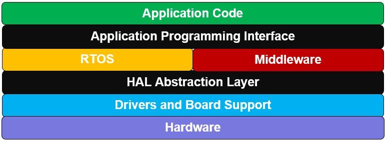

"do you prefer the low layer (LL) APIs or direct register access by means of the CMSIS? "
the wrong way to use any vendor library is to incorporate such libraries directly into your code. once you do that, your code is no longer portable. instead, I often use a layer that sits in between my application code and whatever libraries, mine or others, LL or SPL. with this approach, you don't have to worry about (LL)API or CMSIS.

@henry.dick
You are talking about a hardware abstraction layer (ST's cube HAL is not a real abstraction layer). I'm not asking about HAL APIs, but which approach (CMSIS vs LL) people use in order to implement a HAL. A good software architecture always has got a HAL for the middleware (and application layers). However, in the end each HAL uses either direct register access (by CMSIS), something like ST's cube HAL, or the LL APIs.
