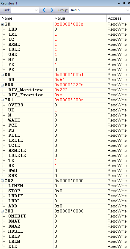

The problem only happens when a constant stream of data is being send to the UART. When I update my firmware sometimes DMA won't work. It is hard to debug when it only happens when updating and not every time.
This post is exactly the same issue as mine: DMA issue post
In the first image below are the registers when DMA won't work. The second image are the registers when DMA is working correctly.
I looked at every register and tried manually resetting and staring the DMA, but still sometimes after an update DMA won't work. I can;t find the source of why this happens and why it won't work even when I hardware reset the controller.

problem
no problem

The issue was that the DMA interrupt wasn't enabled, so the system never entered the HAL_UART_ErrorCallback() when things went wrong. That also explains why the problem was intermittent — it only happened when data started arriving before everything was properly set up.
At startup, the UART overrun flag was being set due to incoming data, but since the interrupt wasn't enabled, no error handler was triggered, and the system couldn't recover.
Enabling the interrupt with:
HAL_NVIC_SetPriority(DMA1_Stream0_IRQn, 0, 0);
HAL_NVIC_EnableIRQ(DMA1_Stream0_IRQn);fixed the problem.
