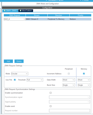

DMA -> in circular mode , for continuous data transfer. Did you set it to circular ?
2024-01-26 1:24 AM - edited 2024-01-26 1:25 AM
2024-01-26 6:05 AM - edited 2024-01-26 6:06 AM
