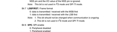

Thanks JW, replace controller is not an option. I have tried to debug but that's not been really helpful and confused me a bit, to be honest. Sure thing I must study more these peripherals I want to use.
It still seems strange to me that with 4-bit datasize it kind of works, but with inverted endianness:
COPI CIPO
0: 0065 6538
1: 0065 6538
2: 0865 6500
3: 0865 6508
4: 1065 6508
5: 1065 6510
6: 1865 6510
7: 1865 6518
8: 2065 6518
9: 2065 6520
Both controller and peripheral devices should be little-endian.
2025-11-20 4:35 AM
It is always an option, when you want to gain an understanding of the details, to use some of the lowcost devboards, such as a Nucleo.
