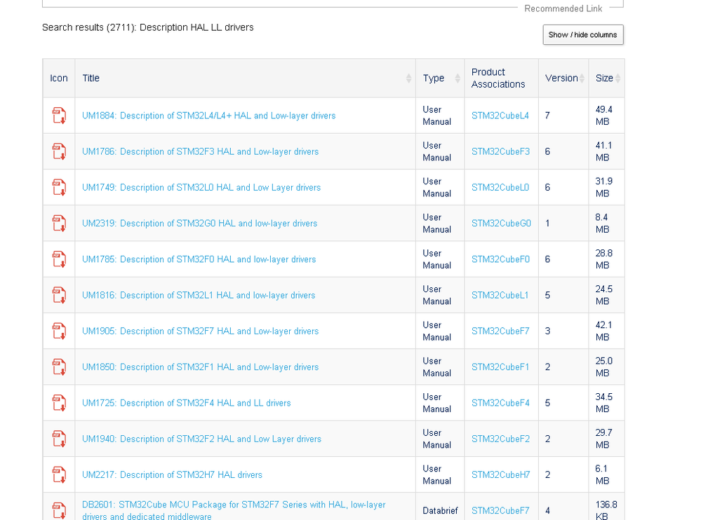

2019-01-29 8:08 AM
Depending on which particular familie's Cube you are using, you should select the appropriate manual:
and go to "How to use HAL drivers" subchapter of the "Overview of HAL drivers" chapter.
