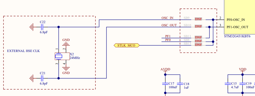

The USB DFU bootloader requires a stable clock, typically provided by the HSE or an external clock source. You can find these details in "1 Bootloader code sequence" in AN3156.
By default, this board has no clock input on PF0. You'll need to close SB13 in order to use the 8MHz clock output by the ST-Link chip.
