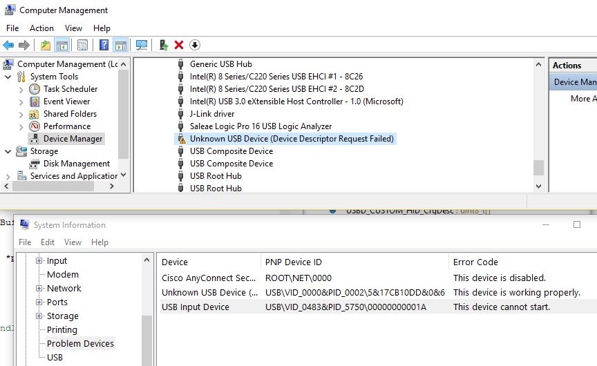

Hello Mayla, the custom HID example from CubeMX USB middleware is NOT enumerating to Windows (which just complains about the device descriptor request failed), as you can see in attached picture. I am wondering if this might be due to the ill-formed CUSTOM_HID_ReportDesc_FS. From what I read in USB Complete, 4th Edition, the 2 bytes (the last byte being ''end collection'') you have as a descriptor is ill-formed. Please find my steps to get to this point in my
http://henryomd.blogspot.com/2016/07/usb-hid-on-stm32f042.html
