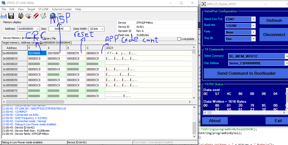

*this is the memory layout after flashing the user app code with appending its CRC at the 1st word at sector 2 (address of 0x08008000)*

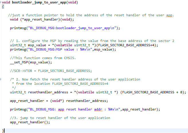

*this is the C function in bootloader code that perform the jump to user app without checking the CRC of app code yet*

Put the CRC at the end of your code, not at the beginning.
Or:
Read, save into a variable but do not program into Flash the CRC value, then program the 2nd word of data to the first Flash location, then, after programming the whole content, check the CRC.

You may put the CRC at 0x08008020 - it's not used by F4.

It's quite generic. Look at ARMv8-M architecture definition and find the unused exception vector in the vector table (first 16 words of memory), then use it for CRC. The exception vector table must start at aligned address, like multiple of 256 - you can't locate it at address 4.
