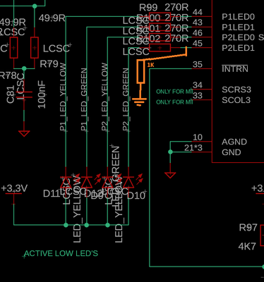

I have made a custom PCB based on STM32H723VGT MCU and KSZ8863RLL with interface RMII. I have followed the Hardware Design Guide for the KSZ8863. Including 100 Ohm impedance from RJ45 to PHY and 50 Ohm impedance from PHY to STM32. Length matching is also done with meanders.
Without any configuration from CubeMx I am expecting some activity on the LEDS when I plug a ethernet cable in the RJ45 connector.
Are there anyone with experience with the KSZ8863 3-port switch, that have any suggestions? I have added a picture of the schematic. The crossed is not implemented on the board, so please ignore those.

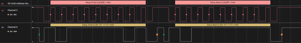

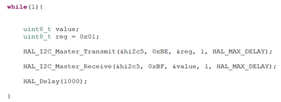

My simple code is above ^. Using the logic analyzer I can see this:
I never received any ACK from the ksz8863. I am trying to read register 0x01 to return 0x3, as stated in the datasheet.
Can you confirm that I am on the right track, @LCE ?

I have no idea about HAL I2C, I can only say that the I2C addresses are correct.
Have you strapped the interface selection pins correctly?
On the logic analyzer we see 0xBE and 0xBF sent out directly after each other, which does not make sense, unless you want to write register 0xBF.
But yeah, first try to get an ACK.

My original design did not have strap, so I have soldered a resistor on 1KOhm as shown in the picture. When pulling reset low, the LEDS on P2LED1 and P1LED0 lights up and then turns off when releasing nRST pin. I can measure 1.8V on pin 32 and 42. I can measure 25MHz from the crystal and 50Mhz on pin 26. But sadly still cant get a ACK when writing to pin 37 and 36... :(

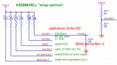

Can you confirm the straps for I2C-slave mode?
2024-09-06 2:44 AM
Don't have time now, check the DS and the pdf for the eval board.
You might need an extra pull-up an P2LED0.
Here's a screenshot of my working setup:
