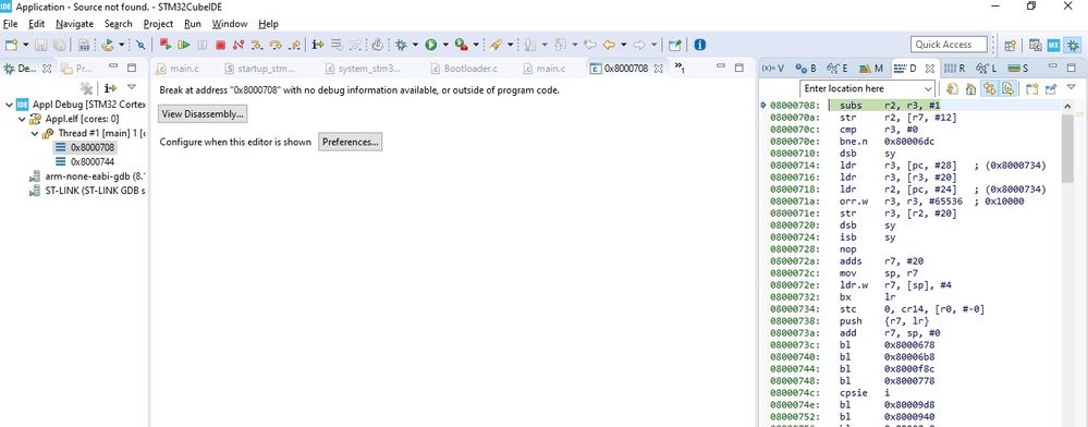

I am trying to develop a custom boot-loader on Nucleo-H743ZI2 evaluation board. But the boot-loader is not jumping to application code. I had referred to the other posts regarding the topic and adopted some code from those also. I had flashed the codes of application and boot-loader to the respective memory locations at 0x8020000 and 0x8000000.
Please do point me to the problem in the code provided.
