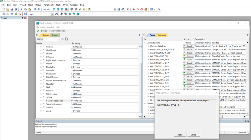

I can not import CubeMX project in Keil.
Problem: The following device family packs are required by the project
Keil:STM32L0xx_DFP:1.6.0.
I have checked from installed packs. it is already there

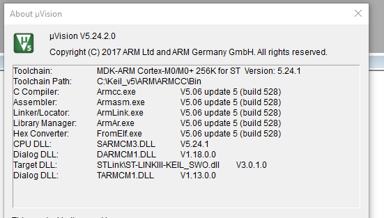

,Can you please precise which keil and STM32CubeMX versions are you using?
Maybe the keil pack is not properly installed.

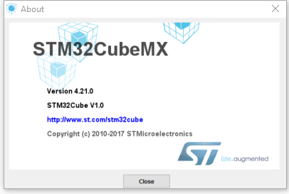

2017-07-12 9:23 PM
Here is what is happening with the pictures.
Version are shown at the end
Opened directly from CubeMx.

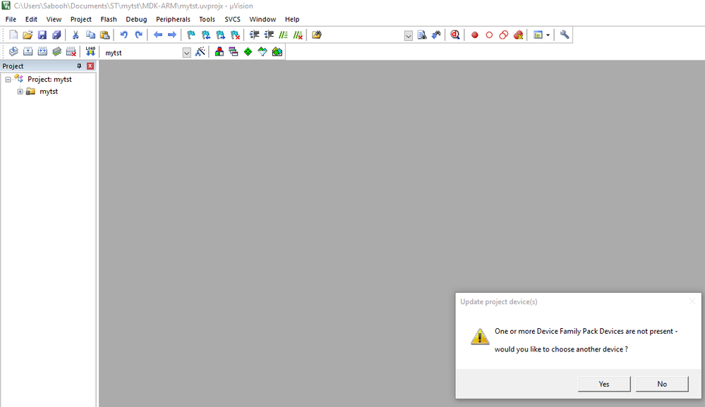

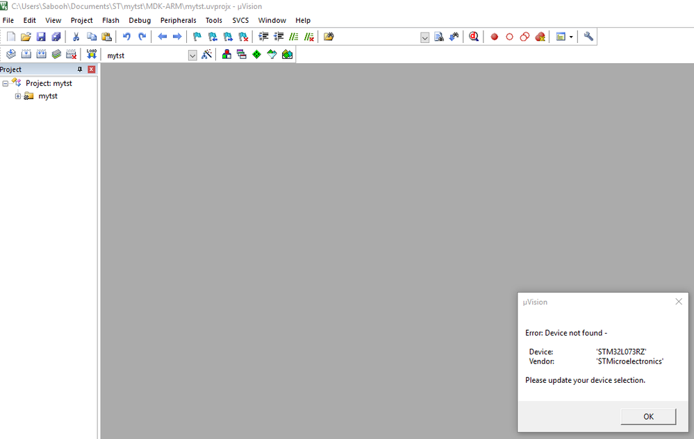

Shows the first error
you can see ---- Keil:stm32L0xx_DFP is up to date

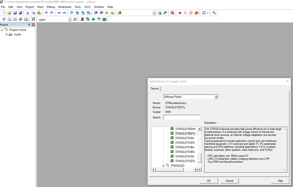

I clicked install
I clicked Yes
I selected the chip
STM32L073rztx

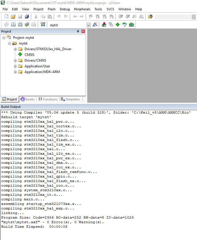

Here is a fun part.
It compiled correctly
2017-07-12 9:39 PM
Kindly, neglect the previous comment(reply)
Somehow the pictures are not coming up.
You can see the errors are coming up. But still compiling correctly.

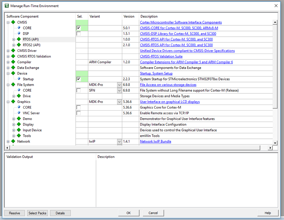

May be the problem is linked to the fact that, I can not see Any option for CubeMx API or HAL options under DEVICE?
any thoughts.
