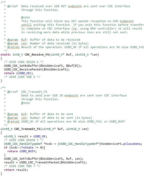

From what I can tell, there are two main functions I should be interested in:
I can see how these two work fairly easily; when data is received, the Receive_FS function is called and stores the received characters in the hUsbDeviceFS RX buffer; when data is transmitted, the Transmit_FS needs to be called and the data parsed into it.
The transmit is pretty easy to understand. After #including the CDC_IF h file into my main, I can simply call the CDC_Transmit_FS function whenever I want to transmit a packet of data - very simple and easy.
The difficulty comes in receiving data from the host. From the code in usbd_cdc_if.c, I can see that the Receive_FS function is called; of interest, this calls the functions USBD_CDC_SetRxBuffer and USBD_CDC_ReceivePacket. This is where my understanding breaks down, and I am not sure how to access the RxBuffer from main.c and process incoming bytes.
I tried doing something like using the "hUsbDeviceFS" variable that main.c has access to, and accessing the RxBuffer through this (i.e. &((&hUsbDviceFS)->pClassData)->RxBuffer). However, this causes the PC to throw a "USB Device Not Recognized", leading me to believe that I am not supposed to do this as it interferes with the normal processes on-going at a low-level.
Can anyone please help me? Perhaps a simple example processing incoming data, but preferably doing it all from main.c. I know I could easily start adding my own buffers and parsing data around in the USBD files, but this is bad practice and I imagine (or at least hope) STM have a way that the user can access the buffer without modifying generated Cube peripheral files - especially when it comes to a propriety, high-speed protocol like USB.
