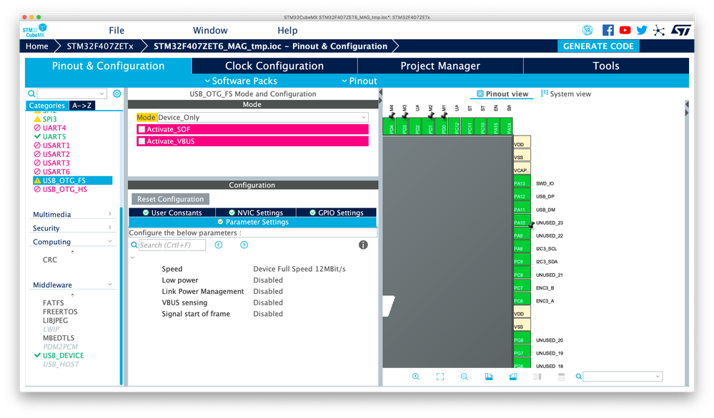

I wanted to implement a simple USB device only on a STM32F407. When I enable it in CubeMX under USB_OTG_FS I get a DP and DM line and there is an option to activate the VBUS line. Is activate VBUS absolutely necessary? It is after a simple device only mode. Also what is Activate SOF?
Also I tried implementing this on a custom board with just the DM and DP lines but I did not see any comms happening. The board is not powered from the USB. So I guess this is a self-powered device only mode. What am I missing?

2021-01-24 9:19 PM

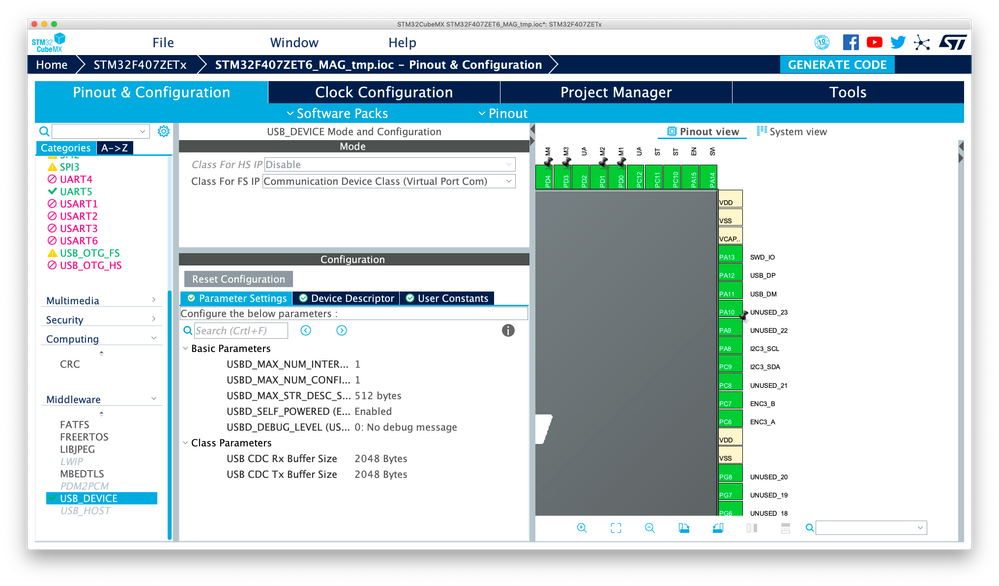

Where exactly should I add that? I see that the USBD_SELF_POWERED is enabled. Here are the settings as they are now.
2021-01-24 9:30 PM
It's a descriptor called USBD_CDC_CfgFSDesc in usbd_cdc.c.

2021-01-26 12:37 AM
Thanks. It seems according to this document (sec 2.6, page 10) VBUS sensing is mandatory if the device is self-powered.
