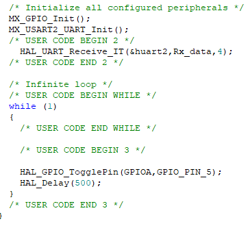

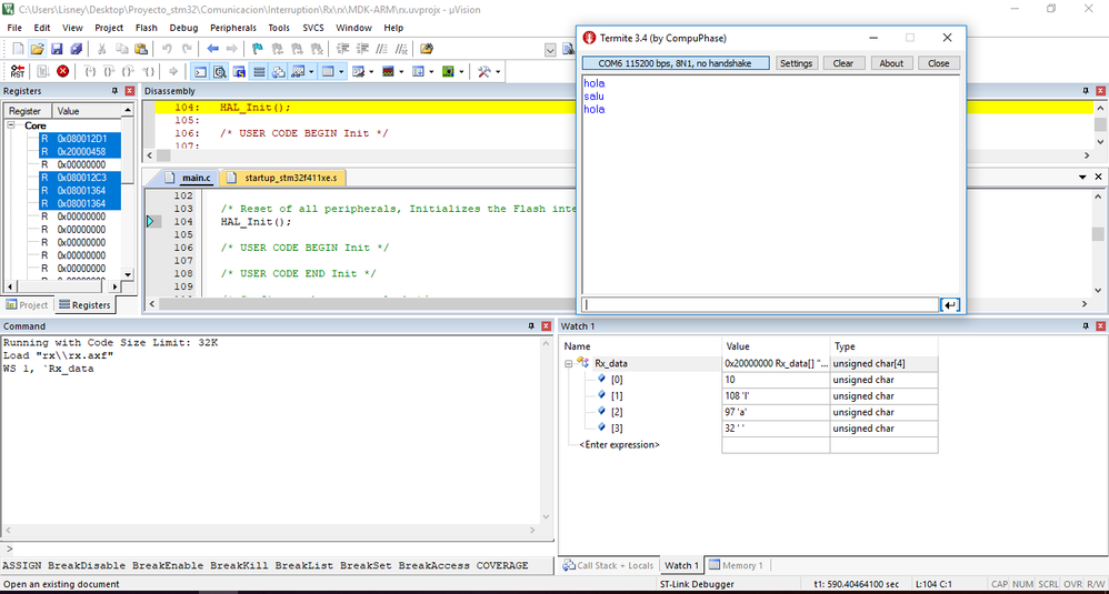

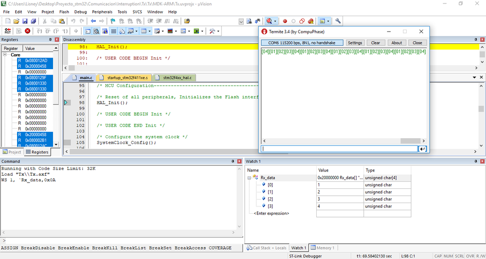

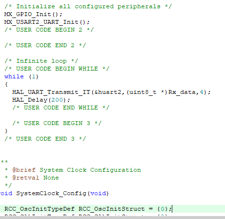

Then I use two different computers to load each part of the code, the transmission and reception and first execute the reception so that it is ready to receive and then the transmission code, however in the reception debbug I observe absolutely nothing.
When I run and test the transmitter code, I test it in this way.
When executing and testing the reception code, I test it in this way
