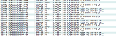

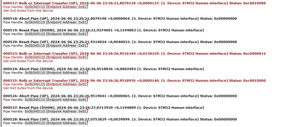

2024-06-06 1:47 PM - edited 2024-06-06 2:27 PM
Ok, so I switched back to the example HID-device from STM32CubeIDE, but the mouse still doesn't work.
The codebase itself is rather small, the main function (using the mouse, doesn't work):
int main(void)
HAL_Init();
SystemClock_Config();
MX_GPIO_Init();
MX_USART1_UART_Init();

The descriptor including and its length are written into usbd_custom_hid.c. Rest of the code is the generated one from STM32CubeIDE. When using the mouse-code from above, no interaction:
- Descriptor with both keyboard ANDmouse: only keyboard example works
- Descriptor with mouse OR keyboard: the specified device works
I've also attached the project's code as a 7z-file.
2024-06-07 8:14 AM
Issue fixed by setting the HID_EPIN_SIZE in the file usbd_hid.c correctly.
