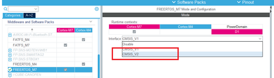

In the tutorial mentioned above CMSIS_V1 is used, but for the MODBUS library which I want to use CMSIS_V2 is required ( Modbus-STM32-HAL-FreeRTOS ).
Now if I simply change CMSIS to V2, i get the error:
make: *** No rule to make target '.../Ethernet_Test_TGFX/Middlewares/Third_Party/FreeRTOS/Source/CMSIS_RTOS/cmsis_os.c', needed by 'Middlewares/FreeRTOS/cmsis_os.o'. Stop.
Is this caused by dependencies not being updated properly or how can I solve this? I already tried Refresh+Clean.

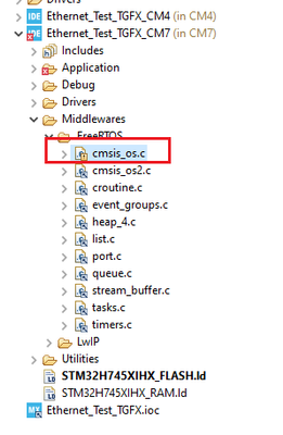

As I don't have your TouchGFX project I cannot test it but you can remove cmsis_os.c from the project tree.
cmsis_os2.c is already added..

2024-09-17 2:33 AM
2024-09-17 4:29 AM
Yeah, that did the trick, thanks a lot!
