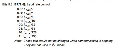

You can configure the baude rate of CR register (calculate APB1/baud rate configured, APB2/baud rate).
In fact, the prescaler define the SPI BUS clock.

The clock is imposed by the master.
What do you mean by real clock w the baudrate is configured in SPIx_CR1 register ?

The master supplies the only clock and the transmit/receive is symmetrical, but can occur on different clock edges.

It depends on the DSP used.
