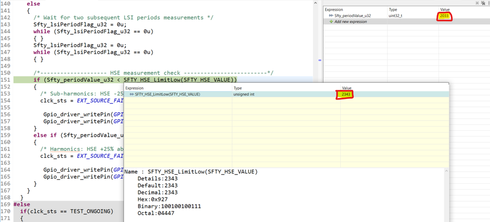

I have done the cross reference test and the LSI period which I am getting with 64MHz sys clock and Timer clock 64MHz is 2033. But the HSE_LimitLow and HSE_Limit_High is 2343 and 3096 respectively. Since the LSI period isn't falling between the limits. The clock test is failing both during runtime and startup tests.

P.S. FYI. The LSI period is captured during the test as an image it is attached to the thread.

The limits according to you has to be between 6400 to 9600 during startup but i am getting the LSI period as 2033. Which doesn't fall under the the limits range right.
I have changed the sysclk macros. But still I am getting the LSI period as same value as 2033 only.
The update in the macro value is not impacting the LSI period.

These macros neither influence LSI period nor any HW setting. Those are only definition of acceptable borders (constants) applied at comparison the LSI period measurement results. I don't know neither your clock tree nor timer input capture system configuration (you need to check configuration of both) and my calculation came from your information that you feed the timer by 32 MHz during the startup (64/2) and use default setting of the timer input capture system provided at the FW package. It is evident that it is not the case as the result of your measurement seems to be 8 times lower suppose timer is truly fed by 64MHz. It looks like you face either higher divider of the sys clock at timer input or do not apply 8 consecutive LSI periods but single one only for the input capture measurement. Please check and adapt either the borders definition or the hw configuration to match all off them together. The basic formula to obtain expected/ideal measurement value is quite straightforward:
measurement result = (timer input fcy / LSI fcy) * (number of LSI periods applied to capture the IC event)
Then the acceptable interval should be defined +/-20% from this expected/ideal value if HSI feeds the timer. There is no mystery behind.
