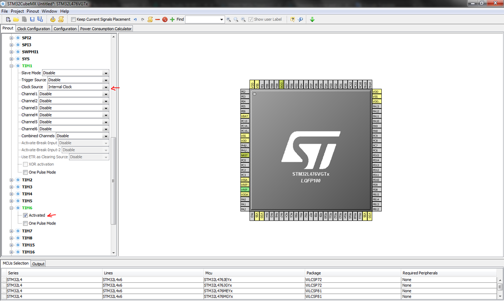

The STM32 microcontrollers family have different timers with different features, but all of those with the basic feature of free counting. If you're using the STCubeMX software, in the pinout tab you can see the features of each timer, and for example you can see that TIM1 to TIM5 have the special features as PWM, output compare and input capture that includes the use of channels for signal input / output, if you don't need a signal then there is not necessary to set any channel. There are other timers that have only the counting mode and the one pulse mode. If you want to make a time count I suggest to use the basic timers, you just check the option ''activated'' and set the parameters (prescaler and counter value that depens of the clock frequency) in the Configuration tab and the interruption. If you want to use a timer with the special features just for free counting in the pinout tab select the timer (for example the TIM1) and then just select the clock source, the TIM1 is now activated and you can set the p
arameters in the Configuration tab and the interruption (prescaler and counter value that depens of the clock frequency).

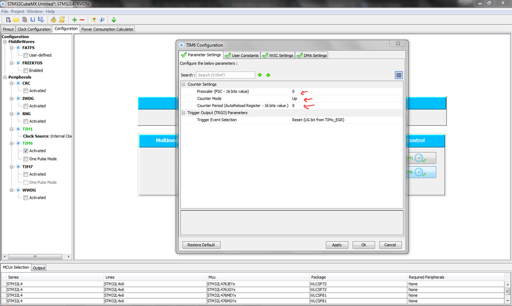

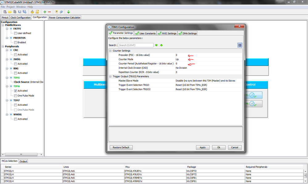

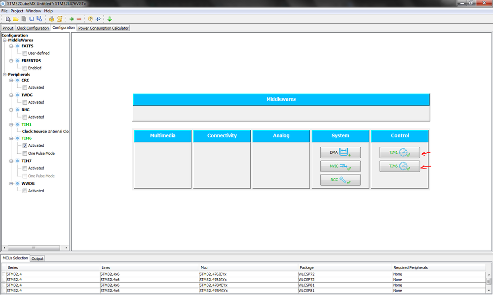

but which channel must I choose? I would like to configure the timer handler struct or doing it through Cube app, but I must choose one of these 4 operation mode channels. I have never seen this before. Since I was working with 8 bit mcu timers where there was only one mode: free run, and you only (brievly said) must to save the value of the period you want to count.
However, thanks for your suggestions. I'm sure they will be usefull immediatly.
