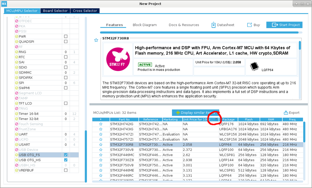

2020-04-15 11:32 PM
> I tried using the product selector but the issue is that it didn't list price as a filter option
Which product selector did you try?
The one integrated in STM32CubeMX can filter and sort by price.
