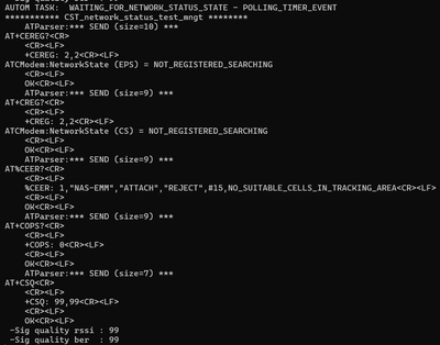

This is the screen I have :
The error message is : "NO_SUITABLE_CELLS_IN_TRACKING_AREA"
So, may be I'm not in the truphone TAC, or a misconfiguration?
Can someone help me to find a solution ?
