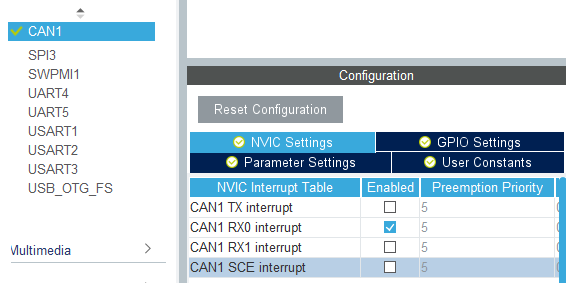

2020-06-16 8:15 PM
The code above is similar to my code.
I'm also working on the STM32CubeMX FW_L4 v1.5.1 library on the Nucleo-L476RG board,
and there is a similar phenomenon that doesn't work like you,
so please let me know when the problem is solved.
If you want to use CAN RX interrupt, add the code below.
HAL_CAN_Start(&hcan);
HAL_CAN_ActivateNotification(&hcan,
CAN_IT_ERROR|CAN_IT_LAST_ERROR_CODE|CAN_IT_BUSOFF|CAN_IT_ERROR_PASSIVE|CAN_IT_ERROR_WARNING|
CAN_IT_RX_FIFO0_MSG_PENDING|CAN_IT_RX_FIFO1_MSG_PENDING|
CAN_IT_RX_FIFO0_OVERRUN|CAN_IT_RX_FIFO0_FULL|CAN_IT_RX_FIFO0_MSG_PENDING|
CAN_IT_TX_MAILBOX_EMPTY);
void HAL_CAN_RxFifo0MsgPendingCallback(CAN_HandleTypeDef *phcan)
if (phcan->Instance == CAN1) {
HAL_CAN_GetRxMessage(phcan, CAN_RX_FIFO0, &rxHeader, &rxData[0]);
// HAL_GPIO_TogglePin(GPIOA, GPIO_PIN_5);//LED
