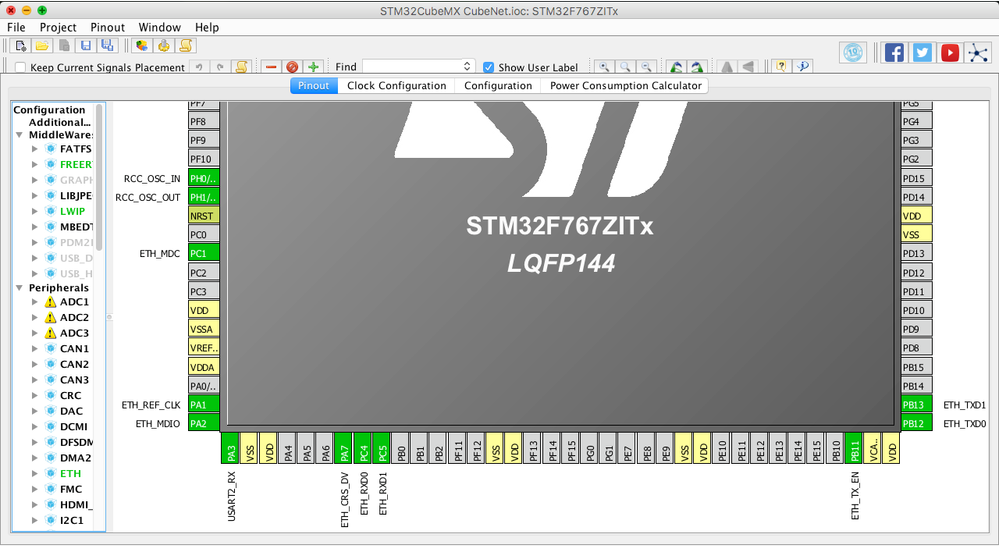

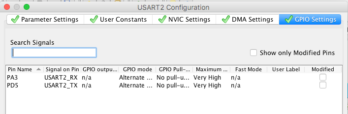

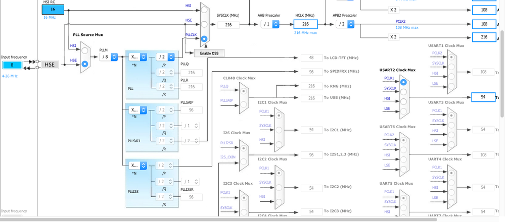

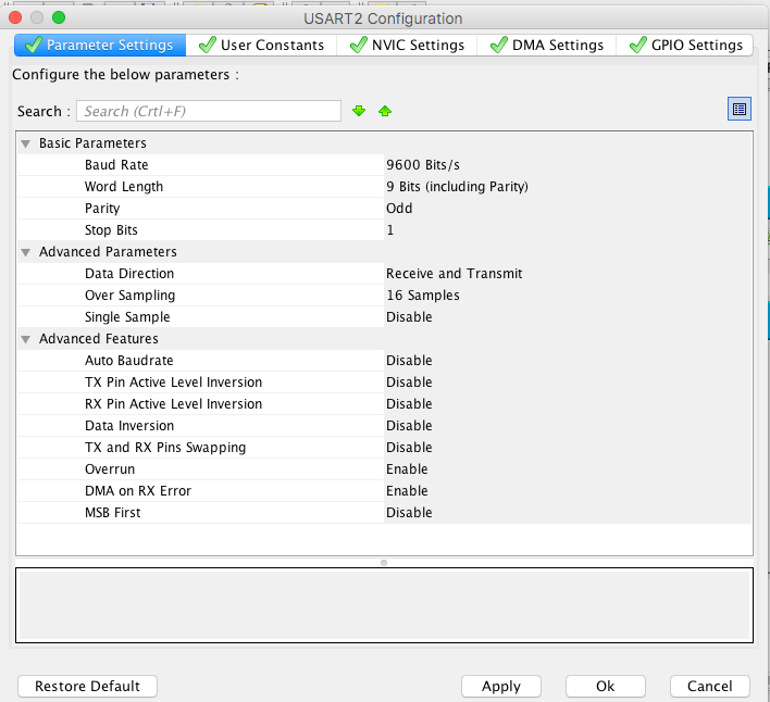

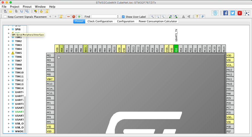

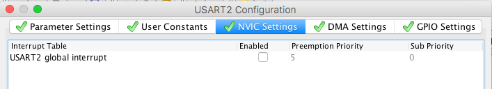

Screenshots of pinout and CLOCK & USART2 configuration:

/* Peripheral clock enable */ __HAL_RCC_USART2_CLK_ENABLE(); /**USART2 GPIO Configuration PA3 ------> USART2_RX PD5 ------> USART2_TX */ GPIO_InitStruct.Pin = GPIO_PIN_3; GPIO_InitStruct.Mode = GPIO_MODE_AF_PP; GPIO_InitStruct.Pull = GPIO_NOPULL; GPIO_InitStruct.Speed = GPIO_SPEED_FREQ_VERY_HIGH; GPIO_InitStruct.Alternate = GPIO_AF7_USART2; HAL_GPIO_Init(GPIOA, &GPIO_InitStruct);GPIO_InitStruct.Pin = GPIO_PIN_5;
GPIO_InitStruct.Mode = GPIO_MODE_AF_PP; GPIO_InitStruct.Pull = GPIO_NOPULL; GPIO_InitStruct.Speed = GPIO_SPEED_FREQ_VERY_HIGH; GPIO_InitStruct.Alternate = GPIO_AF7_USART2; HAL_GPIO_Init(GPIOD, &GPIO_InitStruct);/* USER CODE BEGIN USART2_MspInit 1 */

static void MX_USART2_UART_Init(void){huart2.Instance = USART2;
huart2.Init.BaudRate = 9600; huart2.Init.WordLength = UART_WORDLENGTH_9B; huart2.Init.StopBits = UART_STOPBITS_1; huart2.Init.Parity = UART_PARITY_ODD; huart2.Init.Mode = UART_MODE_TX_RX; huart2.Init.HwFlowCtl = UART_HWCONTROL_NONE; huart2.Init.OverSampling = UART_OVERSAMPLING_16; huart2.Init.OneBitSampling = UART_ONE_BIT_SAMPLE_DISABLE; huart2.AdvancedInit.AdvFeatureInit = UART_ADVFEATURE_NO_INIT; if (HAL_UART_Init(&huart2) != HAL_OK) { _Error_Handler(__FILE__, __LINE__); }}

did you intentionally enable ODD parity for USART?

>> RCC_OscInitStruct.PLL.PLLM = 25;
Pretty sure the board is using an 8 MHz clock, not a 25 MHz one, make sure PLLM is set properly, and that HSE_VALUE in stm32f7xx_hal_conf.h is 8000000

Yes, and selected 9 bits, knowning the HAL-thing that the bits are including parity. I will state also here, that I get zero reaction in terminal app, while clicking 'run' in SW4STM32 on an example-derived project (different project open simultaneously) works.

See earlier message about using the correct PLL settings and HSE_VALUE, compare those to that of the working printf example.
2018-04-04 9:51 AM
Thank you, the firmware example uses 8* in both places, I indeed had HSE_VALUE set to 25000000, weird, It didn't help the UART problem. I'm sure I have correct board selected, proved that once in forum, pasting lines from file *.ioc:

RCC.HSE_VALUE=8000000
RCC.PLLM=8
I've reloaded the project in MX, I was counting on some clock issue to be reported, but nothing. I do following to test the serial communication:

But PLLM and HSE_VALUE were wrong, I've changed them to 8*, the example had correct values. No change in UART (lack of) communication, though.We’re moving the ST Community to a new platform to give you a better and more reliable community experience.
