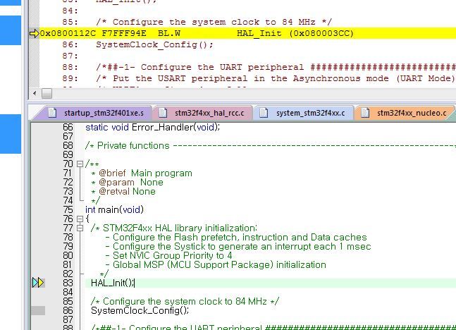

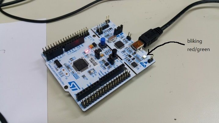

I'm now trying with the original uVision project that came with STM32cubeF4 package.(just added a include path to remove red 'x' in #include line). It compiles ok. When I press Ctrl-F4, the debugger is waiting at the first line of main() because the 'run to main' option is on in the debugger setting. But when I press F5 (run), it doesn't proceed past HAL_init() which is the first line in main(). The assembly instr is ''BL.W HAL_Init''. The LD1 LED on the board keeps blinkig (switching between red and green). The image is shown below. Somebody please help with this, I'm a newcomer into ARM, STM32 and I think many will experience the same thing like me. Maybe the debugger setting of uVision can be wrong. Thanks!(I include the main.c : uart print using HAL driver.)2015-12-02 8:38 AM
If you stop the debugger where is the code stuck?
Can you use the USART independently of the hosting for printf(), putchar(), etc? I've demonstrated the USART on the Nucleo boards with the SPL, I'm afraid I can't help you with the HAL/Cube stuff. No special changes were required to the boards. For SWV output you might want to double check the solder bridges. Make sure you have the most recent drivers and firmware from either ST, or on the mbed site. With the F4 part you're using you'd want to double check the generated code for the clocks, making sure the part is only clocking at 84 MHz, and the flash wait states are set suitably. APB1 should be at 42 MHz, APB2 at 84 MHz2015-12-02 5:17 PM

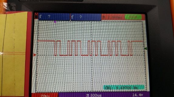

The while(1) {} was not hard fault while statement. It was after the printf.I captured the UART signal from F401RE to ST-LINK chip(F103CB). I used printf(''CCCC''); ascii 'C' is 0x43. I can see 0x43 is transmitted 4 times correctly. And the baudrate seems to be 9600bps. Then the problem is then between ST-LINK chip and my PC. Maybe I'm missing something in uVision debugger setting or so..ADD : when I set 8 bit data, it includes the parity bit, so the picture seems correct. In other direction, I can see when I press my keyboard, the correct value is seen at UART2's DR register(I used peripheral view window). This means PC->STM32F103->STM32F401 is ok. I guess the STM32F401->STM32F103 path has certain error. I now have some questions. 1. How do I set STM32F103's parity bit? Is it set to EVEN parity by default? 2. Or If I set my COM port in the PC's device manager, does it set STM32F103 chip's uart interface? and What affects serial port setting in the Teraterm?(I saw I can set serial port separately, for teraterm and for device manager COM port). 3. Is there any way I can monitor how the STM32F103 chip UART is receiving data from STM32F401?I hope somebody could clarify this to me. Thanks! (my portable oscilloscope that I borrowed from nearby team is out of battery so I cannot see the waveform right now).2015-12-04 4:03 AM
