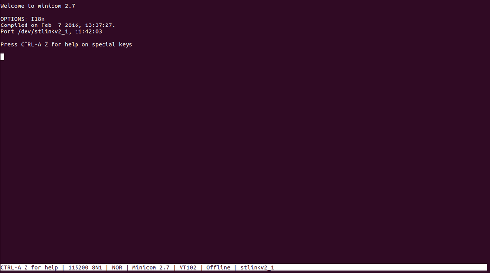

I am trying to run nuttx on STM32F429IDisco device. I am following tutorial from nuttx official channel on youtube. Few days ago i was not able to start minicom. But after some study i was able to start it, using /dev/stlinkv2_2.
https://stackoverflow.com/questions/45627751/minicom-is-not-starting
Anyway, at this moment i am stuck at very next step. My minicom have succesfully started but i can't start nsh to run my programs by clicking reset button.
Can anybody tell me what is the wrong i have done ? stlinkv2_2 isn't right way to setup device? or any other mistake?

I have tried with
stm32f429i-disco/usbnsh but no luck!
still the nsh console is not starting....reset button clicking doesn't start the nsh console.

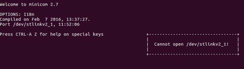

I have configured Serial Device /dev/stlinkv2_1 ... before that i tried tty0, ttyUSB0, ttyACM0, ttyS0.
I got not found errror for USB0, ACM0. tty0 and ttyS0 shows no error.
When i configured
/dev/stlinkv2_1
at least the device responses. I mean if i unplug the usb at least it shows warning..What should i do now ?
