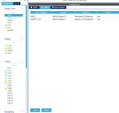

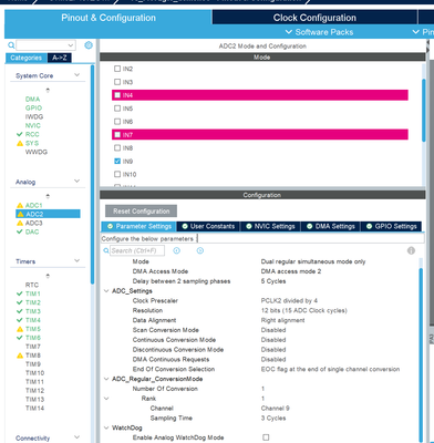

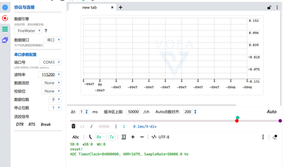

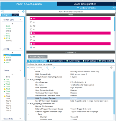

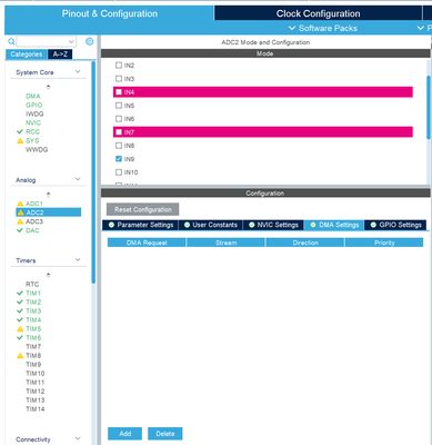

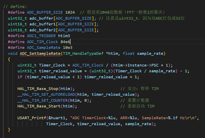

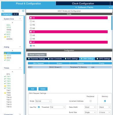

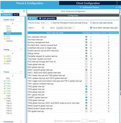

I configured dual DAC synchronous sampling,DMA is in normal mode for data transfer.
When the timer frequency of the ADC is 10KHz, the main cycle can print serial port information, but when the timer frequency is 50KHz, the main cycle does not print ADC data information. What is the reason for this? Below is my cubemx software configuration and related code.

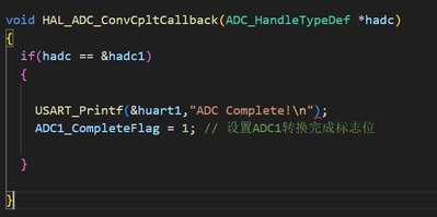

Printing out samples over UART at 50 kHz is a non-starter. The bandwidth is insufficient.
In general, don't put long blocking calls like UART transmissions in your interrupt handlers.

uint32_t adc_buffer[ADC_BUFFER_SIZE]; // 注意是uint32_t,因为双ADC打包成32位
uint16_t adc_buffer1[ADC_BUFFER_SIZE];
uint16_t adc_buffer2[ADC_BUFFER_SIZE];
#define ADC_TIM_Clock 84e6 // 定时器时钟频率
#define ADC1_TRIGGER htim3
#define ADC_BUFFER_SIZE 128 // 假设采2048组数据(FFT一般要2的幂次)
#define ADC_SampleRate 50e3
void ADC_SetSampleRate(TIM_HandleTypeDef *htim, float sample_rate)
uint32_t Timer_Clock = ADC_TIM_Clock / (htim->Instance->PSC + 1);
uint32_t timer_reload_value = (uint32_t)(Timer_Clock / sample_rate) - 1;
if (timer_reload_value < 1) timer_reload_value = 1;
HAL_TIM_Base_Stop(htim); // 安全:暂停 TIM
__HAL_TIM_SET_AUTORELOAD(htim, timer_reload_value);
__HAL_TIM_SET_COUNTER(htim, 0); // 重置计数器
HAL_TIM_Base_Start(htim); // 重新启动 TIM
USART_Printf(&huart1, "ADC TimerClock=%lu, ARR=%lu, SampleRate=%.1f Hz\r\n",
Timer_Clock, timer_reload_value, sample_rate);

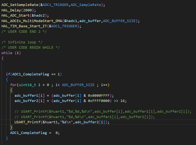

ADC_SetSampleRate(&ADC1_TRIGGER,ADC_SampleRate);
HAL_Delay(2000);
HAL_ADC_Start(&hadc2);
HAL_ADCEx_MultiModeStart_DMA(&hadc1,adc_buffer,ADC_BUFFER_SIZE);
HAL_TIM_Base_Start_IT(&ADC1_TRIGGER);
/* USER CODE END 2 */
/* Infinite loop */
/* USER CODE BEGIN WHILE */
while (1)
if(ADC1_CompleteFlag == 1)
for(uint16_t i = 0 ; i< ADC_BUFFER_SIZE ; i++)
adc_buffer1[i] = (adc_buffer[i] & 0x0000FFFF);
adc_buffer2[i] = (adc_buffer[i] & 0xFFFF0000) >> 16;
// USART_Printf(&huart1,"%d,%d,%d\n",adc_buffer[i],adc_buffer1[i],adc_buffer2[i]);
// USART_Printf(&huart1,"%d,%d\n",adc_buffer1[i],adc_buffer2[i]);
USART_Printf(&huart1,"%d\n",adc_buffer2[i]);
ADC1_CompleteFlag = 0;
// Key_Process();

void HAL_ADC_ConvCpltCallback(ADC_HandleTypeDef *hadc)
if(hadc == &hadc1)
USART_Printf(&huart1,"ADC Complete!\n");
ADC1_CompleteFlag = 1; //

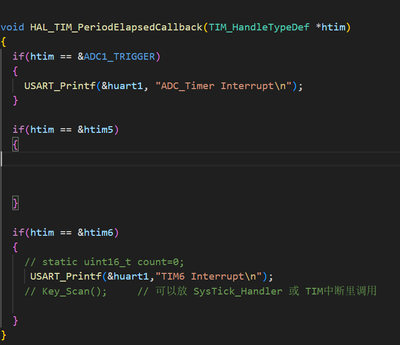

void HAL_TIM_PeriodElapsedCallback(TIM_HandleTypeDef *htim)
if(htim == &ADC1_TRIGGER)
USART_Printf(&huart1, "ADC_Timer Interrupt\n");
if(htim == &htim5)
if(htim == &htim6)
2025-06-10 8:32 AM
I still don't understand
My DMA works in normal mode and only starts once after powering up, and no more after that. Just set the flag of the ADC sampling in the ADC callback function. Waiting for the ADC to complete the acquisition in the main cycle, and then printing out the data, what does this have to do with the serial port rate?
