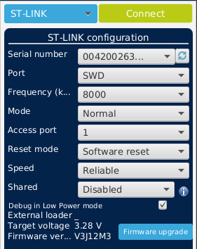

That worked well, now I can access the device using SWD. Pardon me as I am fairly new to STM32 and am a little confused regarding the BOOT select and all the option bytes. I am reading the reference manual and the data sheet but the wordings confuse me.

Option now "normal" , swd access with reset .
What other setting you want ?
First try also : software reset
(I dont have G03 , so i cannot try...working, or not.)
2024-06-24 2:31 AM
Yupp, Normal and Software reset works too. If possible can you help out with the nBoot bits as well. I would like to reprogram the board using UART, which is not possible at the moment as, I think the code is directly jumping to the firmware regardless of the state of the NRST pin.
