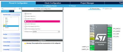

Does the SWD work on a brand new chip. If I just unpack and solder a new IC to my breakout board, would I be able to connect to CubeProgrammer via an ST-LINK? While programming via UART, I did enable the the Serial Wire interface as you can see in the image below, but unfotunately did not pay much attention to the boot pin's option bytes while flashing the firmware from the CubeProgrammer. My understanding was that the since PA_14 pin is common for Boot0 and SYS_SWCLK, the serial wire would override the option bytes, and I can use SWD without tinkering with the option bytes.

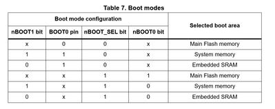

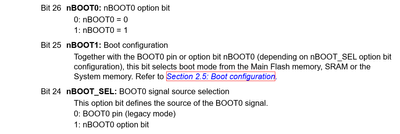

From rm , boot option byte set to "always bootloader start" : (0xFF)
and boot mode :
11 -> main Flash
BUT:
-> So it starting always (your) program , except on new chip, when no program loaded .
Thats why you could use the serial - link, to load your program ( first time on new chip).
This is over now...

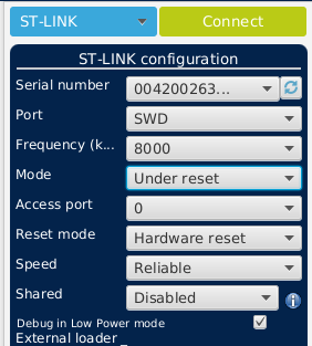

You should get connection with st-link : ST-LINK , set "under reset" , hardware reset. Try...
+ check: connection to st-link "reset" : NRST to your G030 - this should be in working condition.
