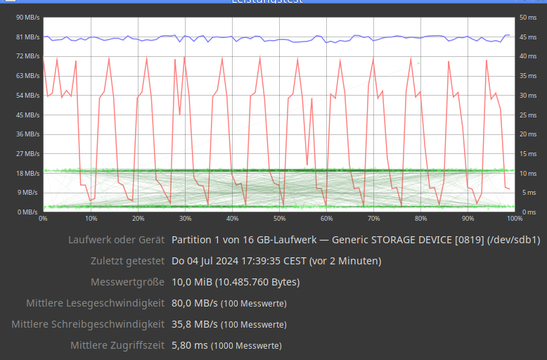

Here a speed check , on PC /Linx , on USB3 (5Gbit possible), to see, what cards doing...
red: write, from 4...60MB/s ; green access time : 0.5 ...10ms . card: Intenso, 16GB , SDHC, class 10 .
The up and down on writing 10MB blocks come from....whatever the card doing internally.
And this is a new card....you dont wanna see, what a 2 y old doing, if all day used for logging data.
