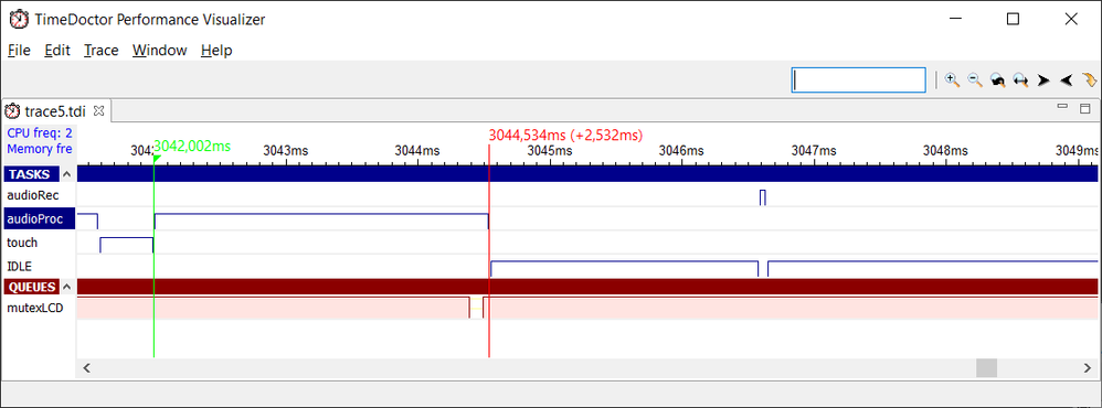

2021-10-26 2:13 PM
Here is a TimeDoctor trace of a FreeRTOS project with 4 scheduled tasks:for TimeDoctor see https://gitlab.com/KnarfB/timedoctor (work in progress)
