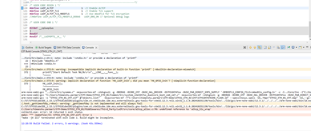

I have STM32H747I board. using Ethernet, I have connect MQTT on 1883 port successfully. Now I want to connect 8883 port but after configuration, this kind of error occurs also I have included path for the same. can you please check and give me step to resolve this.
Thank you.include path
error

for broker on port 8883, I have changed in file name "lwipopts.h"
#define LWIP_ALTCP 1
#define LWIP_ALTCP_TLS 1
after changes in "lwipopts.h" file, I getting erros as mentioned earlier.

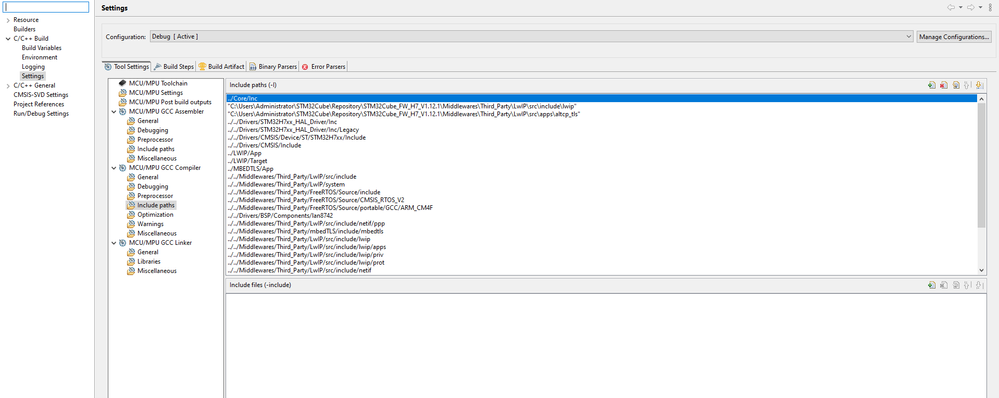

ERROR: >> undefined reference to altcp_tls_wrap
for resolve I have manually add path in project build file but the result was same.
please give me how can I use broker on 8883 port for mqtt connection using LWIP stack and what are the configuration.

I'm having the same problem. It's because the altcp_tls_mbedtls.c is not included in the Middlewares/Third_Party/LwIP/src/apps directory. altcp_tls_mbedtls.c is where altcp_tls_wrap is defined. I don't see a configuration option in the GUI to include this file, and if I manually add it, then the file will get blown away by code regeneration if I reconfigure my project. @Himanshuparmar did you find a workaround to this issue?
