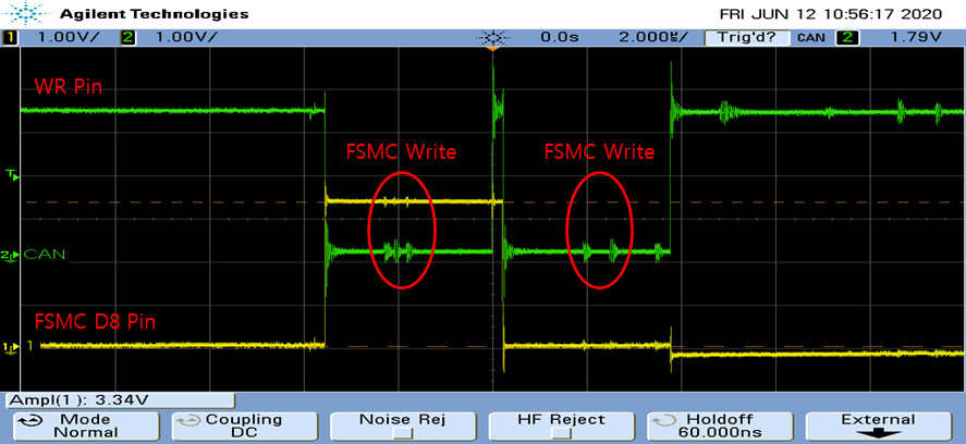

I implemented ili9341 lcd as fsmc and found the following problem.
the problem is that when calling HAL_SRAM_Write_16b, it writes data once more.
I attach the measured fsmc waveform.
I can fix HAL_SRAM_Write_16b as follows:

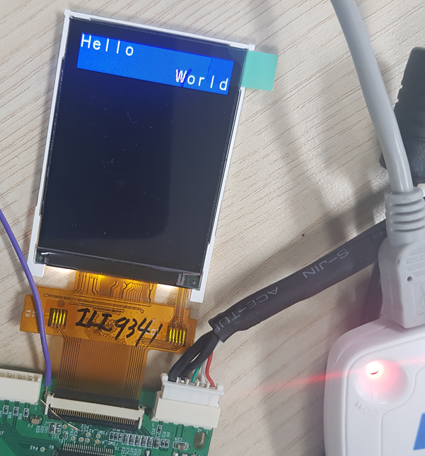

}After fixing as above, LCD Works.
