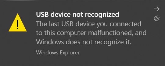

6) Start copying above file from STM drive
7) In the middle of copying unplug the USB cable
8) Plug USB cable back
9) From this time USB is not recognized by the operating system anymore
