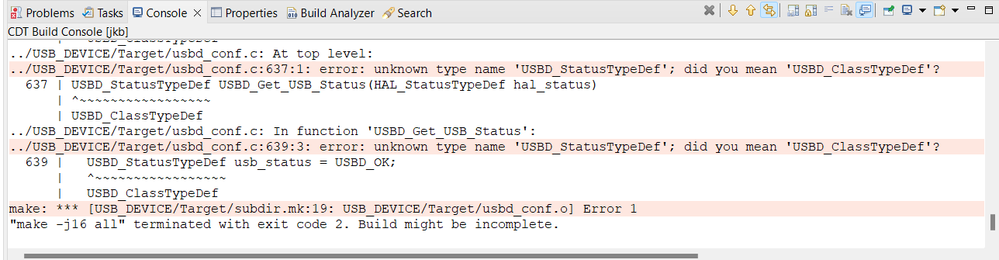

Hi, today I found an pretty unusual bug while doing some projects with the USB CDC, my code, out of the blue, showed hundreds of errors, after some diggins, me and a friend, found out that in the usbd_def.h, the TypeDef of "USBD_StatusTypeDef" was changed with an "q", I think it must have been some mistake while updating the libraries.
Anyway, just change the letter "q" in the line 209 to "USBD_StatusTypeDef" of the usbd_def.h folder and the errors should disappear.

I made some tests using STM32CubeIDE.1.12.0 version and the STM32Cube_FW_F1_V1.8.0 firmware version and I didn't find any issue.
The "USBD_StatusTypeDef" is well described in line 209.
So, I advise you to download and to use the last firmware version of STM32CubeF1.
Please let me know if the problem is solved.

Hi @KDJEM.1 , I am using the STM32F103C8Tx - LQFP48. (BluePill).
The STM32CubeIDE version is the 1.12.0 (But it was appearing in the 1.9, but I updated it and even reinstalled while trying to fix the error).
The firmware I am not 100% sure in wich version it was, but since I updated the CubeIDE and even reinstalled it (with the latest versions), I think it might be the latest.
If you need any more information, feel to free to ask, I will be glad to help.
When your question is answered, please close this topic by choosing Select as Best. This will help other users find that answer faster.
