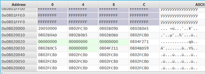

I am developing a bootloader for the STM32H563 that is stored at the beginning of internal Flash (0x08000000) and the application is stored at 0x08020000. The application runs fine when I program/start from STM32CubeIDE once I changed the linker script to set the appropriate Flash address and the VEC_TAB_ADDRESS to be 0x20000 in system_stm32h5xx.c, so the application runs fine on its own from the new 0x08020000 address.

app_reset_handler();The app_reset_handler is set to the correct Reset_Handler address stored at 0x08020004 (0x0802FC3D)...
....but after the app_reset_handler() is called I used the debugger to attach to the application .elf and it was in the hard fault handler. I tried to step through again and once it jumped I detached and attached to application debugger and it seemed to be stuck in the HAL_Delay()...so not sure what is happening.
