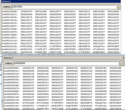

2025-07-08 10:50 PM
1.i flash the app in flash address 0x08010000
2.and flash the bootloader in flash address 0x0800000
3. use bootloader jump 0x08010000, but i can not found the app run(because led cannot Flicker)
please see my project bootloader and app,how i can let it run normal ????

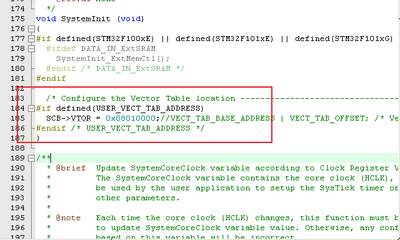

in SystemInit() function try to assign your application address directly instead of Doing OR operation with Base address and offset. try once doing this.
SCB->VTOR = 0x08010000; //VECT_TAB_BASE_ADDRESS | VECT_TAB_OFFSET; /* Vector Table Relocation in Internal SRAM. */
Make sure this address is valid starting address of a perticuler sector. for that you can go through with data sheet or reference manual of your controller.
2025-07-09 6:04 PM
i modify code like this
but the problem still exist!!!! the problem is led on but not flicker, the correct is flick.
