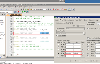

i modify bootloader main.c and test, the problem become the led on but not Flicker, why Flicker????

2025-07-09 1:18 AM
In the User Appilcation we must take care these things:
1. In the system_stm32fNxx.c file search for VECT_TAB_OFFSET and we have to change it with the offset of our user application address.
For example, if flash base address is 0x08000000UL (also address for bootloader) and we want to start the application code from 0x08018000 then I will just add Vector Table offset to 0x00018000.
#define VECT_TAB_OFFSET 0x00018000U 2. Now we have to change __ICFEDIT_intvec_start__ & __ICFEDIT_region_ROM_start__ macros address in the stm32f746xx_flash.icf linker script file present in EWARM folder. And these address will be our User Application address.
define symbol __ICFEDIT_intvec_start__ = 0x08018000;
define symbol __ICFEDIT_region_ROM_start__ = 0x08018000;for MDK-ARM:
if your not missing any of this method then definatly it should have to work.
2025-07-09 1:24 AM
yes, i modify it already but it does not work.you can open my projct
in the last attachment!!!!
so why????

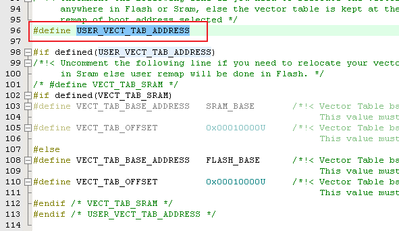

2025-07-09 2:28 AM
in your screen shot VECT_TAB_OFFSET looks like it is disabled. at line no. 96 uncomment the USER_VECT_TAB_ADDRESS first. then try again.
for further verification you can use Cube Programmer to see whether your application code is present at perticuler sector
