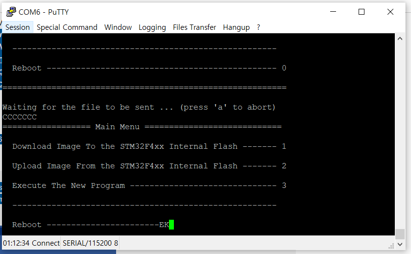

I'm study bootloader.
using STM32F401RE at windows10.
when i download bin file, below picture error occured.
i attach my bootloader and application.
best,
Kim

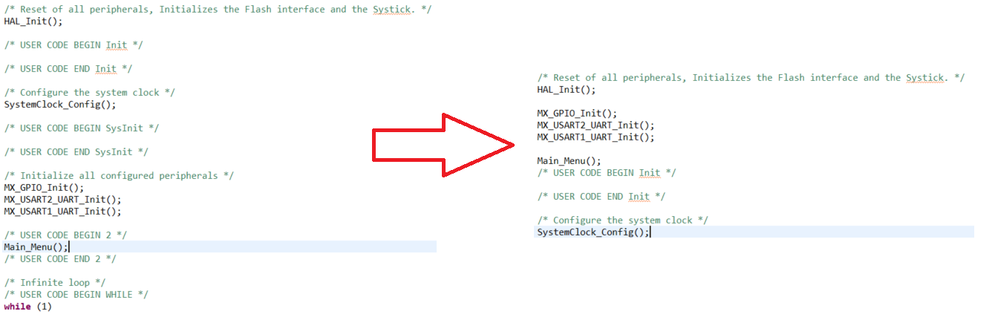

Hi Mattias,
Of course, Yes I am.
This problem solved by my head. Just change code like below picture.
But I am wondering how this change solved the problem.
Best regards,

Hi Mattias,
Best regards,
