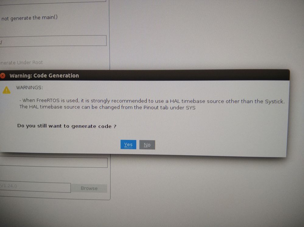

I'm trying to Blink 2 leds using freertos. The code in generated by CubeMX. When generating it shows like the image attached below. So I go to Sys tab and select timebase source as TIM1. When I flash the code I'm not able to see any output.
When I still generate the code without changing the timebase source(i.e. timebase source as SysTick), I got an error TIM_HandleTypeDef is not defined(at this void HAL_TIM_PeriodElapsedCallback(TIM_HandleTypeDef *htim)). So I included #include "stm32f4xx_hal_tim.h" this line. The code got compiled but not able to see any led blinking on my board.
