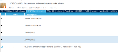

Hello @M_Sukumar,
You can generate your project using STM32CubeMX, choose B-L4S5I-IOT01A as a Board Selector and add the X-CUBE-BLE package from Help > Manage embedded Software packages > "STMicroelectronics".
