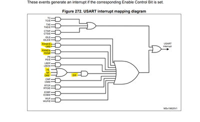

Hello @Andrew Neil ,
From a Hardware point of view, I think booth events are not related:
but in the HAL implementation the enable of the UART Error Interrupt: (Frame error, noise error, overrun error) is inside the UART_Start_Receive_IT maybe try to set this bit before entering the interrupt and you should be able to detect errors once the HAL_UART_IRQHandler is called we test if error accrued if this bit set and not cleared this on the entry of the function :
if ((errorflags != 0U)
&& (((cr3its & USART_CR3_EIE) != 0U)
|| ((cr1its & (USART_CR1_RXNEIE | USART_CR1_PEIE | USART_CR1_RTOIE)) != 0U)))
Regards
