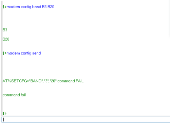

I have made an interface between stm32 and the modem, through serial communication(UART3). The modem answer ERROR to the following commands :
--> AT%SETCFG="NB_CATEGORY",1 and AT%GETCFG="NB_CATEGORY";
--> the command AT%SETCFG="BAND","3","20" or AT%SETCFG="BAND",Band3[,Band20]]. How can i set the bands?
I try to set the bands with the X-CUBE-CELLULAR but it gives ERROR too.
What am I missing?

2021-10-29 10:48 AM
Dear MDuar.2
Can you clarify what do you to achieve? Do you want to limit the number of bands to B3 and B20? Is it because you do not want the Modem to scan all band at boot up to optimize the boot time?
The AT command AT%SETCFG is not supported for the commercial version. If you have to change the bands then you should use the AT%SETSYSCFG command. You can download the AT command specification from MURATA website.
