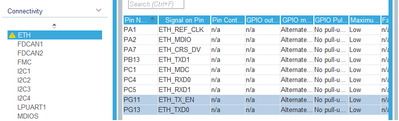

I have changed pins for the Ethernet adapter in the Nx_TCP_Server project according to schematic.
Result is absolutely amazing - now program freezes in the static void MX_USART3_UART_Init(void) at the line if (HAL_UART_Init(&huart3) != HAL_OK)
It is a real magic! How changing pins for Ethernet can influence the USART3 ? Pins are completely different...

For example: in your ioc : Mcu.Pin59=PG11,
in CubeIDE's ioc :             Mcu.Pin18=PG11
And in the MB1364 schematic I see that PG11 corresponds to the pin 126 (!)
So I don't understand in which god I should trust ! ;) But Ok - this is a secondary problem for now.
