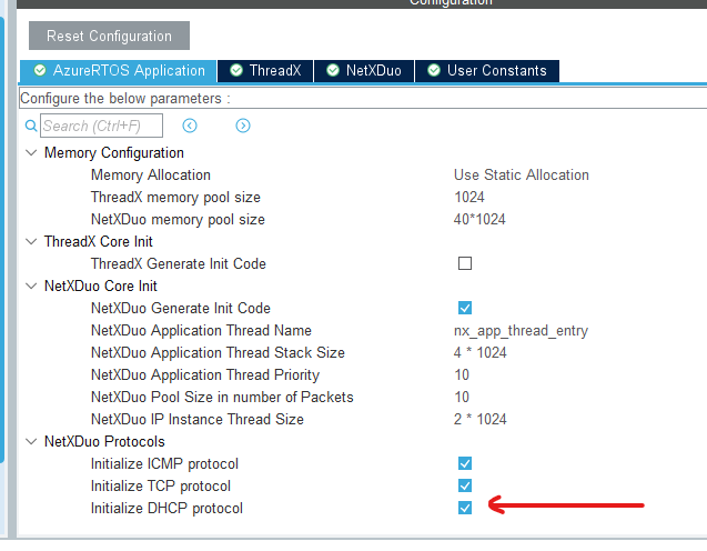

I am trying to enable both DHCP and UDP in my Azure RTOS NetXDuo application, but when I enable DHCP the UDP selection is hidden, and vice versa. Why is this happening?

Hi @Community member ,

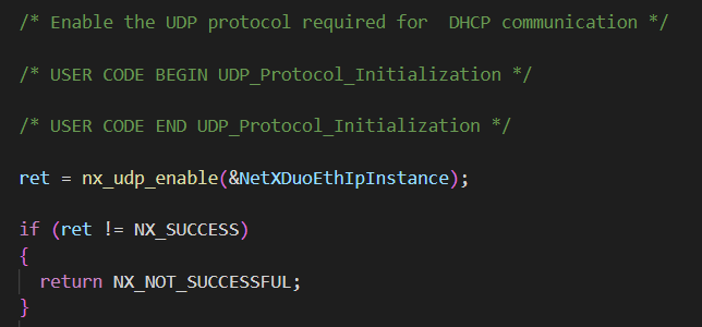

DHCP protocol is using UDP to send requests, so when the former is enabled the latter is too.
please check the generated code when the DHCP is enabled you'll notice something like.

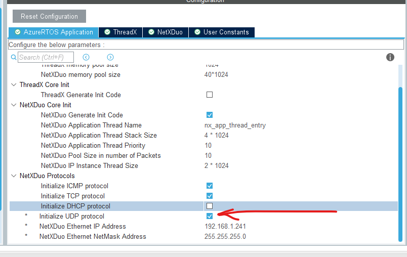

Thanks Haithem. However, I need to create both a UDP client (streaming audio) and a TCP/IP server application on the same board. How do I define the client UDP port?

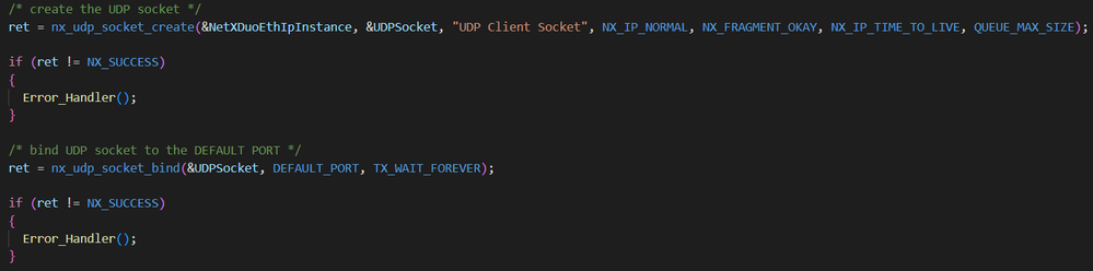

2023-03-28 3:34 AM
Hi @Community member,
you'll need to create an UDP socket first then bind it to listen to specified port as below:
please refer to the Nx_UDP_Echo_Client for more details.

Thanks Haithem. So I assume there is no way to set the UDP port within the CubeIDE GUI?
