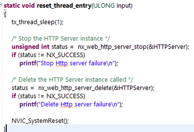

The process use NVIC system reset.

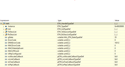

The ethernet handler shows an error on DMA

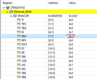

The DMA error appears on ethernet handler even when the application works. On the SFRs its possible to see the RBU bit. This bit indicates that the application owns the next descriptor in the Receive list, and the
DMA cannot acquire it. Why this is happening?

You're going to reset anyway. Disable the ETH and its DMA after http_server_stop() ?
