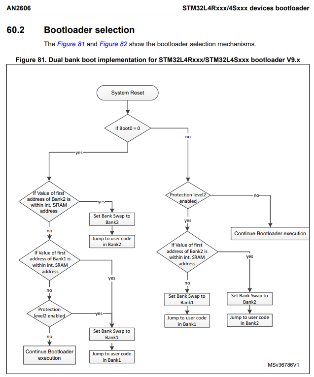

It's very repeatable for us -- A reboot with Bank 1 erased will remain forever in the ST Embedded Bootloader (System Memory 0x1FF00000+) and even though BFB2 is set, the MCU will never reach the valid code in Bank 2 . :confounded_face: :confounded_face: :confounded_face:
The behaviour we are seeing does NOT match the documented boot process (shown below) -- the content of Bank 1 should not be a factor when BFB2 is set (and Bank 2 is valid).

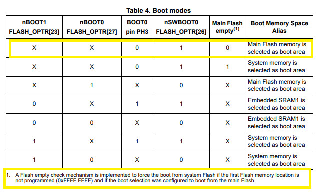

In RM0432, we describe the usage of BFB2 as following:
To select boot from Flash memory bank 2, set the BFB2 bit in the user option bytes. When
this bit is set and the boot pins are in the boot from main Flash memory configuration, the
device boots from system memory, and the boot loader jumps to execute the user
application programmed in Flash memory bank 2.
The boot pins configuration is described in "Table 4. Boot modes":
The explanation of what you see is in the note of this table. That is why you boot as expected from Bank2 if you write something on Bank1.
So, if BOOT0 is pulled low and Main Flash is empty, you will boot from System memory (as shown in line 2 of the table).
You can force boot from main flash memory in such case if you clear the PEMPTY bit (FLASH_SR register).
If BFB2 is set, you can boot from bank2 in case nSWBOOT0 = 0 and nBOOT0 = 1 whatever is the status of PEMPTY.
I agree with you that "Figure 81. Dual bank boot implementation for STM32L4Rxxx/STM32L4Sxxx bootloader V9.x" of AN2606 needs to be reviewed.
